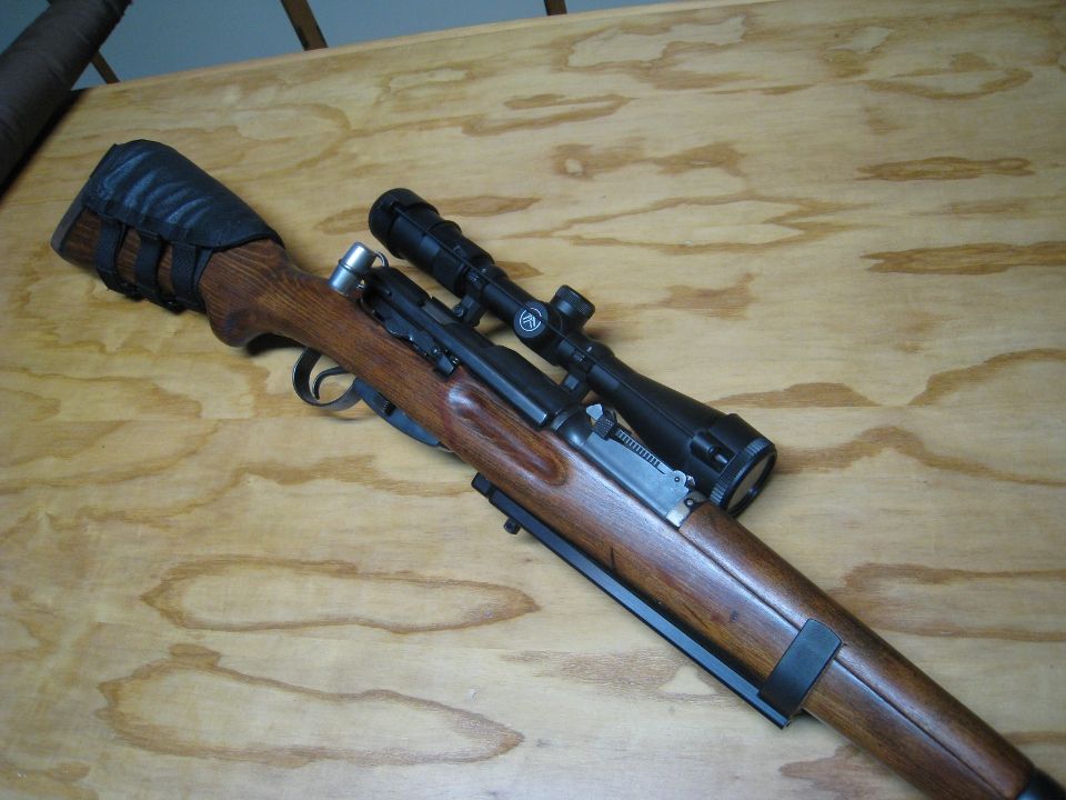

                None of that is right Jagdkampf. My Dad owns Swissproductsllc.com and the mount puts you 5/8 to the right of a 1" paster at 100 yards. If you aim at the left edge of the paster you are dead center. That 5/8" is the same at 100, 200, 500 and 1,000 yards....... and the k31 WILL go to 1,000 yards. The k31 holds the Guiness world record for that class of rifle with open sights at 1,000 yards. My Dad's friend Ernie did the shooting with reloaded cartridges and the 190gr bullet.
                [B]1911sr[/B] :)
                Swiss Rifles and Paul Reed Smith Bass Guitars.... The Best of the Best.
                • #9
                  Re: Scope on Swiss K-31 ?
                  Maybe you'd like to see my Brother's k31 and his 190gr reloads at 125 yards?
                  5 rounds, and the same after 25 rounds, every time... and with our own off-set scope mount.
