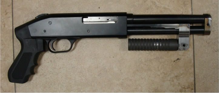

    Just test fired the new KEG shotgun in .410 - holds 2 plus 1 in the mag tube, weighs in at 3lbs 14ozs, 17 inches long. Sounds like a newborn - it was born/created this afternoon. These are AOW's so the tax stamp is $5.00

      Are the action bars welded to the vertical grips' mounting block?
      Split-clamp up front? Is that a front sight I see on top of the clamp block?

          We make what I call The "barrel loop" for the front end. We turn down the dia. on the front of the barrel -side the "loop" over the end and I tig weld it to the barrel. Top loop over the barrel and the bottom loop over the mag tube. Then I use a countersunk socket flathead to attach to the mag tube. This way its almost impossibe for the barrel to come apart from its mount. Yes on the action bars being welded. No front sight - at least not yet.
